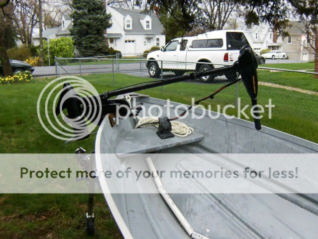

Hi SHIZZY - I have a 12'er V-hull Sea Nymph and I use a transom mount Minn Kota 36lb mounted on the bow. Underneath the "head" of the motor there is a single bolt. If you remove it you can turn the head 180 degrees then re-install it. I mounted a permanent plywood mount for it, but you could just use the clamps on the motor to keep the plywood in place.
Reaching the tiller can be a pain in the $#@% when it's turned far to the right or left, so I'm considering getting one of those tiller extensions with a univeral type joint. Let me know if you want me to take some pictures of the set-up to give you a better idea of what I'm taking about.:D

Re: FD bow mount trolling motor?
Here's how I have mine set up. I have the wood attached the same way the transom wood is. Since it's on the curved part of the bow there is very little flex in either up or down positions. I've hit some bumpy conditions with it in the 'up' position while using the gas motor and while towing and it's never budged an inch. My boat isn't a classic like yours so I didn't have any hesitations about drilling into it though.
It looks kind of odd, but works pretty darn well. Hope this helps!:D

Wiz's mounting is the most common and simplest, good work! You can also make it angled under the motor, to straighten the motor to the boat. I've seen others do transom style clamp-on mounts, either boughten or home made. Sorry, for now I can't show an example. A concern could be, if your motor has enough shaft length for this boat. At the bow, my standard length shaft transom motor would be about one foot to short.
