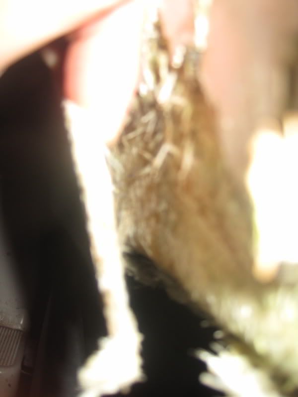

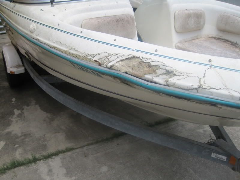

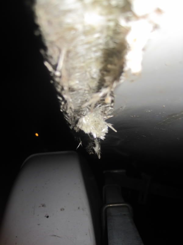

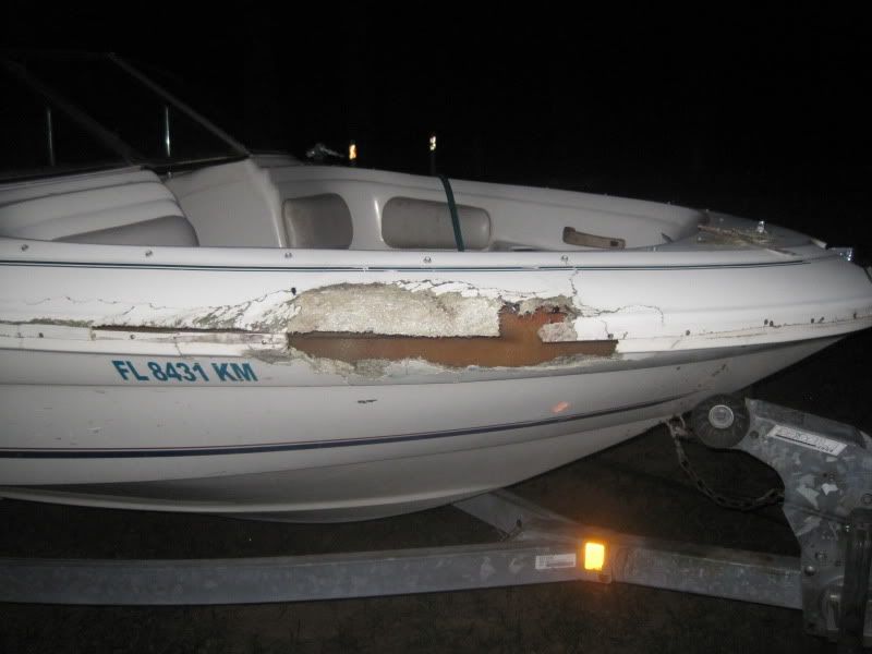

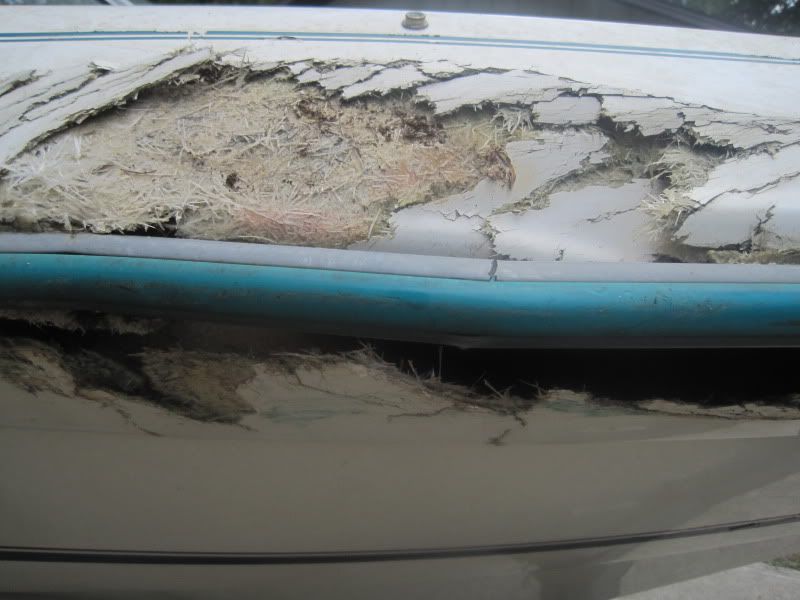

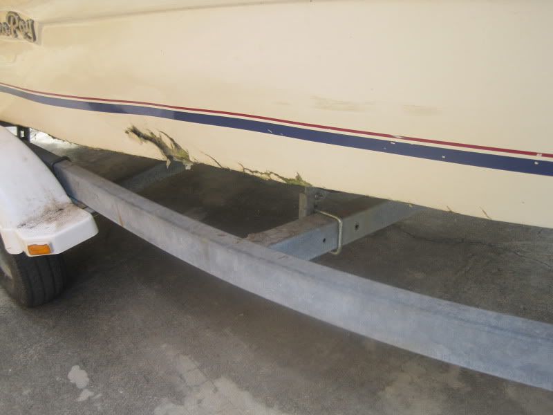

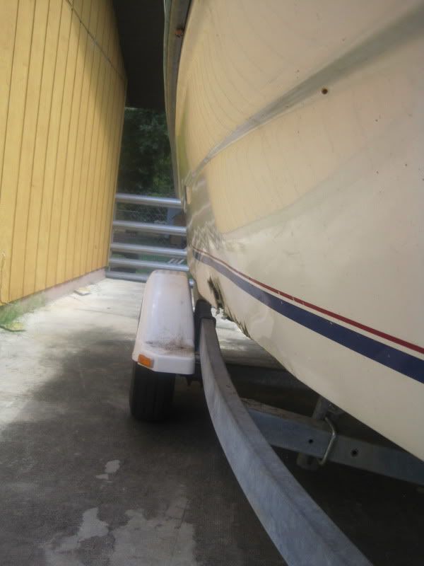

This is the very bottom of the hull on the right of the hull. This "scrape" is probably 3 or so feet long
Another picture of the same, bottom of hull.

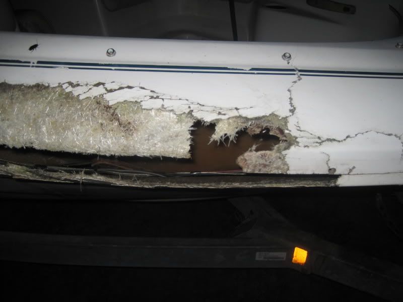

This is the right side of the boat right above the very bottom.

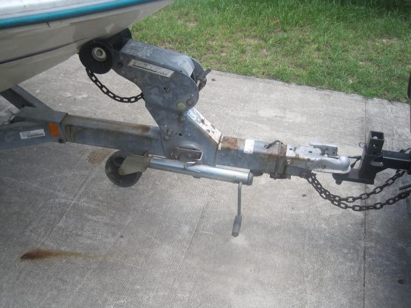

Galvanized Trailer! (esaily worth the $100 alone)
On the very bottom of the hull right below the damage that you can see, it looks like a metal marker was drug along the corner and messed it up pretty good, which is exactly what happened when the boat was nearly on it's side while they were trying to turn left sharply to miss the marker, which they were obviously not successful at.
I'll get more pictures in the daylight when I can, but hopefully this will get me started.
So basically, where I am right now = can I repair the boat without separating the top from the bottom, and do I need to repair the bottom of the hull from the inside.

If the hull damage is through the hull you will need to repair it from the inside and outside.
Supposedly the boat didn't take any water on the way back to the dock, unless a little splashed into the gaping hole in the bow.

It can be fixed, but you will need to take the cap off, not only to do the repairs, but also to see just how much damage has been done. Gel coat will hide all the small fractures in the laminate and the only way to see them will be from the backside.
You'll need to get a little creative in recreating the shape of the destroyed areas, but it can be done.

Hello jmcknight and welcome to Iboats..
The only small problem I see with this is going to be that port side chine damaged area.
From the pics it looks to be "oil canned" about 2'x3' at the chine hullside.
The hull deck joint damage can be done withought removing the cap..however the bottom damage must be done Inside and out Correctly.
In this case I would highly recommend you find a qualified glass guy to keep tabs on your repair If you choose to do this yourself.

as ondarvr and erikgreen said.....the proper way to do the repair is to pull the cap. yd is also correct in saying it CAN be repaired without pulling it, but chances are you will have a wobble in that area and you will inevitably end up glassing the cap and hull together if you leave it on.
make no bones about it.....each repair is an inside out repair.....that means you have to fix both the inside and then the outside. and yes.....your deck (floor) in the rear area has to be opened....dont be shy...take out enough as you need to get at the area unrestricted. you will also need to take out the foam in that area and replace it after the inside repair. and yes...the foam in that area is wet, it will never dry...i dont care how long you let it sit...dig it out and replace it.
