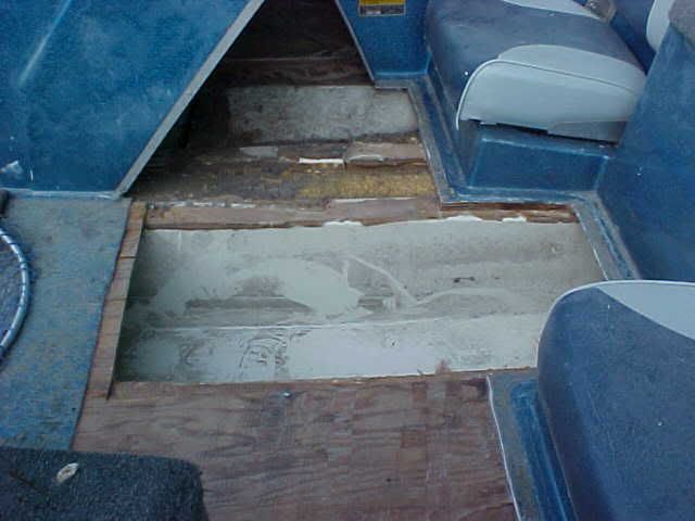

Project of the day was getting ready to replace soft spots in the floor of my bass boat. After cutting away a lawyer of glass and gelcoat and tearing out the old wood to my surprise the stringers and the whole inside are fiberglassed and gelcoated. I have never seen this before. The stringers appear to be almost 3-1/2" thick. The boat is a 1983 Z880 Winner. Is this common in Winner boats?
So I guess this means that the stringers will never rot or will at least be a whole lot harder to fix if they do.

Boat looks solid and strong built. Good to see when someone puts more effort in making quality. I once had a 1976 Norwegian "Fjord" daycruiser, and all the stringers in that were gelcoated too. Even 25 years later there wasnt a spot of bad wood. Mine was only 1" though, with a 1 1/2 reinforcement moulded to the sides on top of them. I dont think you will see any stringer problems in that boat, and no transom problems either.

If they are 3 1/2" thick, then they are more than likely foam cored stringers. A common design.

I have a winner center console. It has the foam cored stringers. It's a well made boat.

I have the same boat as Studly. It seems that Winner was about the first boat with no wood in the hull design. The bulkheads and stringers are a one piece assembly that is bonded to the outer hull. One less thing to worry about.

Thats good news, I dont think there is wood in the stringers. After removing the screws that hold the plywood subfloor down I dont see any wood through the holes at all. I will try to get better pics but there doesnt seem to be any wood in the stringers. This is the first time that I have ever seen a boat made like this and its good to know that I will never have to replace the stringers.
