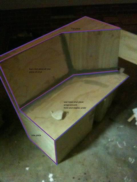

Here is what i'm thinking of the vinyl layout.... basically a top piece, side piece, seat base piece that will wrap the front section and the back will be one large piece that will wrap under the bottom as well.
Another crappy MSpaint drawing...lol (the red is where i'm thinking seams will be)
Any suggestions or improvements?????
JDA1975
Lieutenant
Aug 27, 2011
1,385
Re: Fiberglassing custom fit seating
I would do top and sides, but not attach to back piece of vinyl...leaves you more flexibility to pull tight then on the back use a stiffener across top to staple the back pull tight to bottom then staple sides with hide-em strip...also for your angled corner add a peice to the seam allowance similar to how I did my bulge on the last seats and that will keep that corner tight, top and bottom

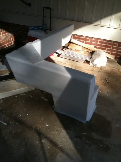

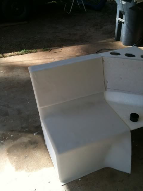

FIrst, I glued two layers of the 2" foam together to make the seat cushion:
The seat cushion will snap into place (snaps are already in place on the "built-in" section in the boat)

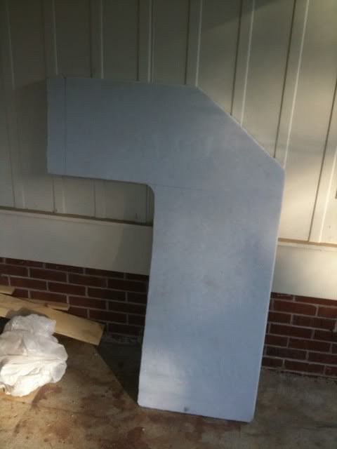

I glued 2" foam for the backrest into position:
I also shot a few staples to help hold things in place, especially in the corner.

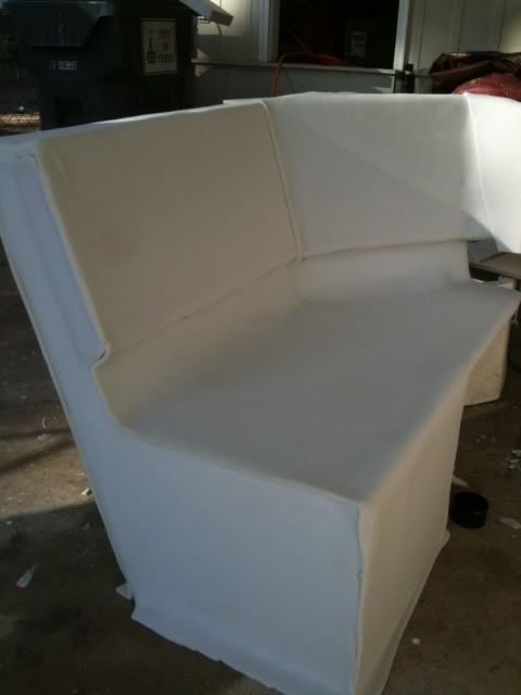

After the 2" foam, I wrapped the entire seat with 1/4" foam:

Tomorrow I will do the vinyl and complete this project!

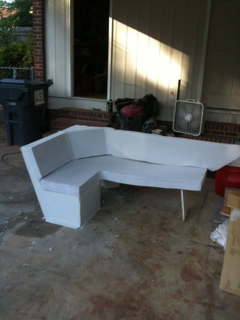

I mocked things up to give an idea of the seating area, I actually did this in the boat but didn't get a pic until I pulled everything back out...
I'm very pleased with how this is turning out...(so far)....the vinly will be the tricky part.
After I eat dinner I will head back out and glue a layer of 2mil plastic sheeting over the entire thing to prep for the vinyl.
I have plenty of hidem to use where needed and am still undecided on how to actually layout the vinyl. Once I cut the stuff..thats it...no going back!!!

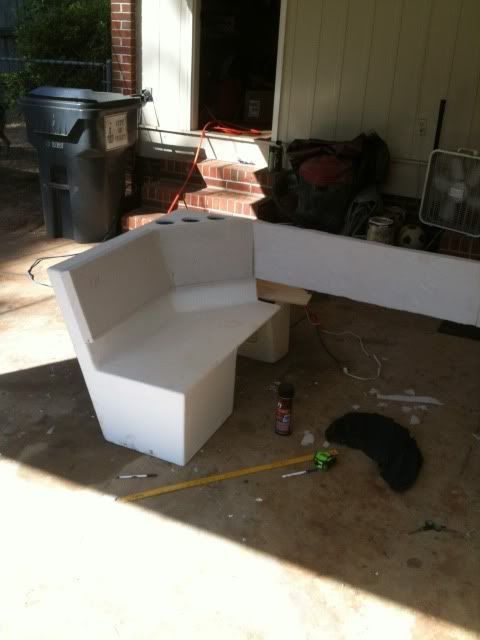

btw, I haven't cut out the cupholders or storage area yet...I'll wait till the vinyl is layed over to cut them out and wrap tight.

might want to cut the cupholders out before covering with vinyl so you can find them...the foam shouldnt move so cutting them out now wont hurt, looks good, should be comfy
Ciera2450
Apr 8, 2011
1,049
good point judge! I'll cut the foam out of the cupholders and the storage area prior to vinyl. That would really suck if I was all finished and cut a hole in the wrong place! Thanks for the heads up.
