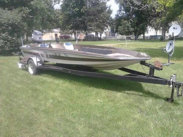

I was thinking about the foam to but the down fall to that is there isn't mutch room between the haul and the floor. When I tore it down the factory foam was from floor to haul with no way for water to drain. the floor had drains in it with pvc pipe layed to the bilge area but no way for water that made it past the floor to drain. I could stack 2 bottles side by side along the center stringer for about 8' but that's about it for room. The voids between the bottles would allow water to drain back to bilge area.
