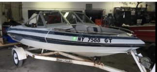

I bought it gutted. The remnants of foam appear to be pour in. Not sure if the factory intended on the foam being structural or just a more cost effective means of manufacturing.
it’s a very shallow hull if that helps. The boat in the pic is not mine but the same hull.

Found a pic. This one is mine. Shows how flat and shallow the hull is at the back.
