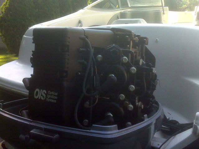

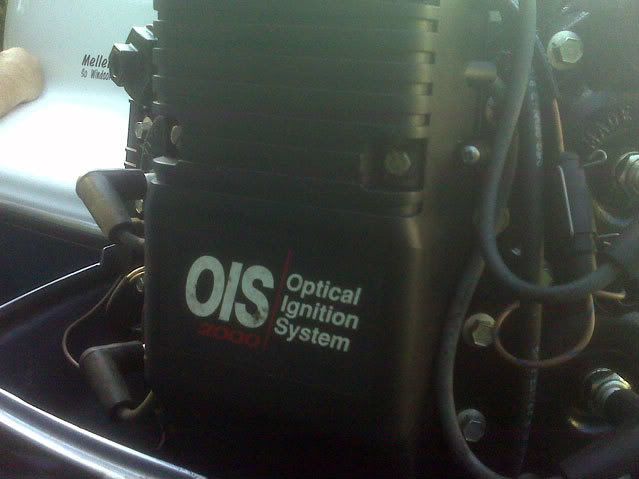

Re: FICHT? How to tell - Johnson 115hp year 2000
Hi Everyone,
So right before I left I called a Four Winns dealer that told me that Four Winns didn't use the FICHT engine at all that year, or maybe any year. Not sure if that is valid, but the boat I looked at tonight I think is NOT a FICHT, can you guys confirm?
MOD#: J115PLSSB
SER#: G04733640
CE:6/1999
It also had this information on the engine:
"Optical Ignition System" OSI 2000
On the side of what I think was the carb and looked like some sort of fuel pump was 439209
9:49:55
5/26/99
95235
Mexico

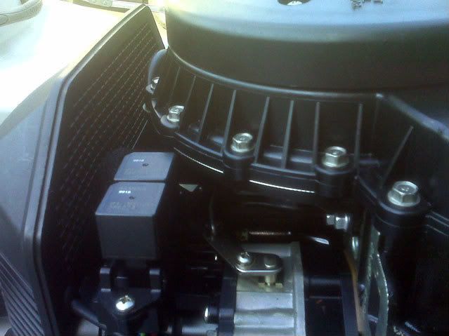

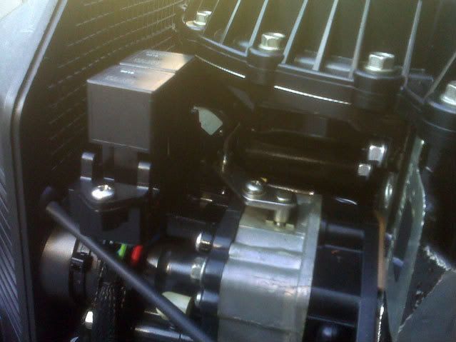

The inside of the engine looked literally Brand spanking new, I was amazed.
Almost looked like it might have had 4 carbs but may have been 2, or is this the FICHT? From the link posted to the parts site earlier it looks like this engine is a straight up Carbed engine. Can you guys confirm? Is it 2 carbs or 4?
EDIT: I am also still trying to figure out if this boat is a 2000, or a 1999. The guy said he thought it was a 2000 but it might technically be a 1999? For the engine I checked the serial number on the evinrude parts site that tashasdaddy posted on the first page of this thread and the engine model shows up in the 2000, even though its manufactured date on the engine is 06/1999. I'm sure this is common to manufacture for the year ahead. Can anyone confirm this?
Four Winns have almost nothing to do with all this, they make and sell Boats, the Motors are sourced elsewhere, that serial number appears to me to be a 2000, 115HP CARBY Motor, so do all the usual checks and your done, the checks are basicaly the same, regardless if it is a Carby or a Ficht, the same rules will apply.
