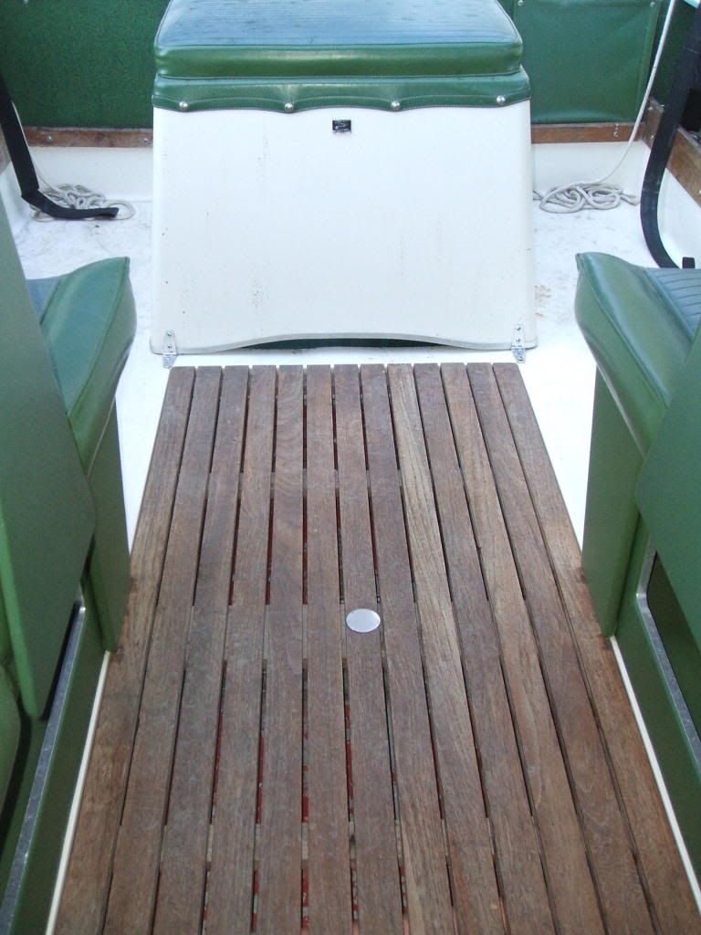

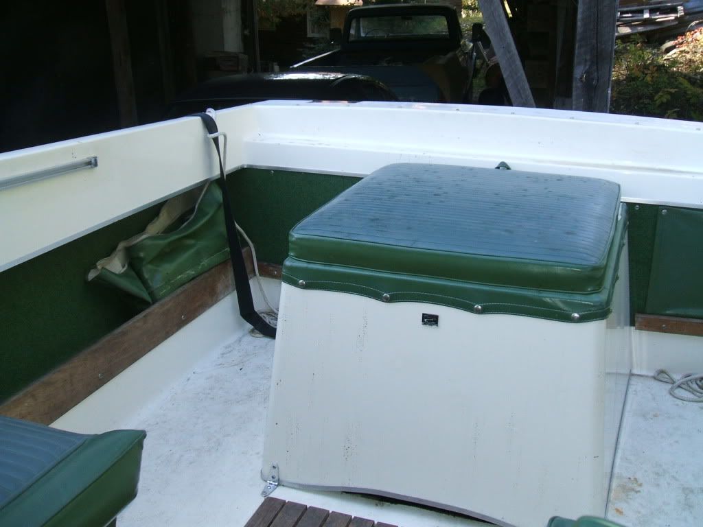

Slickcraft used a lot of teak in their boats, how about some interior pics.
If you don't want to get into it I'll be glad to take it off your hands :D

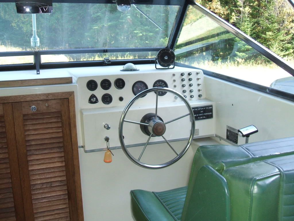

Some teak. The fuel tank cover in the floor is teak as are some of the trim boards along the sides etc.
The doors to the cuddy cabin appear to be mahogany.
