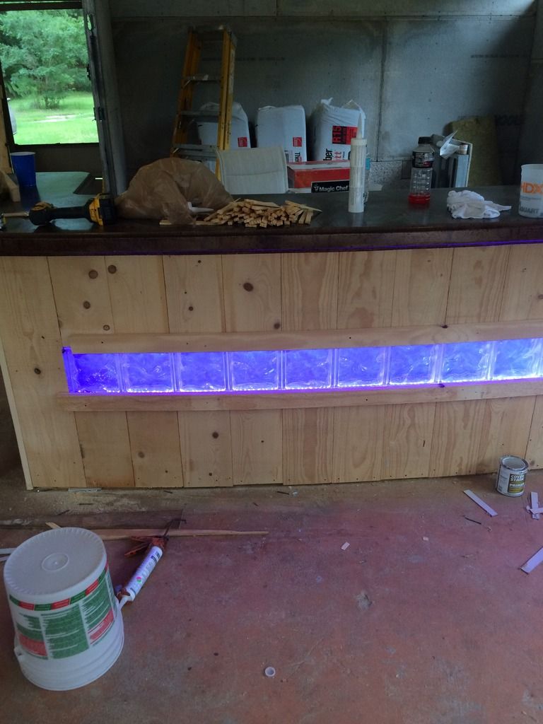

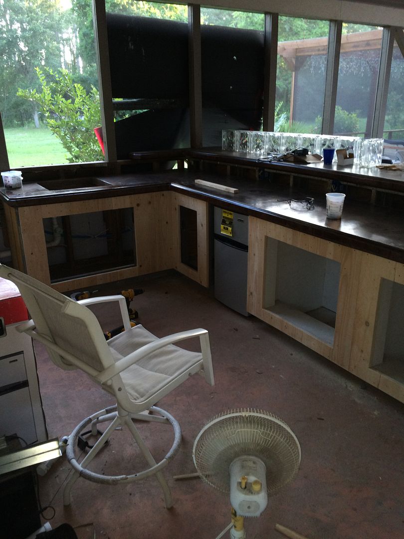

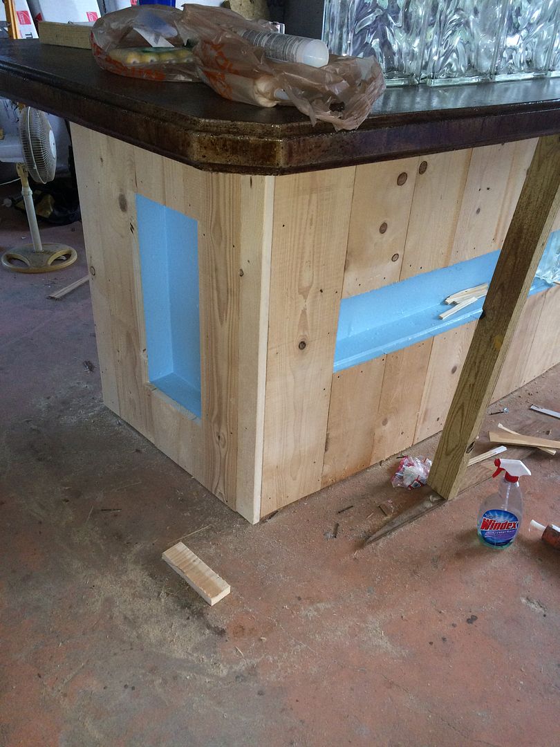

Got a little done today .. Tubing was a blast but a whole days worth takes a lot out of ya .. Installed most of the pine skin on the cabinets ...
Started installing the glass blocks but I think I need to drop back and punt on the installation ..
As you see I am using shims to set them in place and it will be siliconed in place ... I wanted to get some at the back of the block so basically just put a blob in there then set the block ... This just looks kind of goobery and inconsistent ...
So my thought was to cut a plywood strip that I can screw in just behind the blocks ... That was I can layy a nice even bead of caulk up against the plywood back stop then shim and spot caulk in place ... Let that set then fill the rest of the void up solid ...
The LED lights will go in that 1/4" space at the front edge of the block . Then I will trim the edges with the pine ...
The blue inset at the end of the bar will be where I stash the fire extinguishers..

Kc , Thats the plan but using silicone so the light can still pass through ... I wanted to get these in place so after a better strategically placed bead of caulk it worked out ok ... I'll pull the shims out tomorrow then fill the rest of the voids ..
