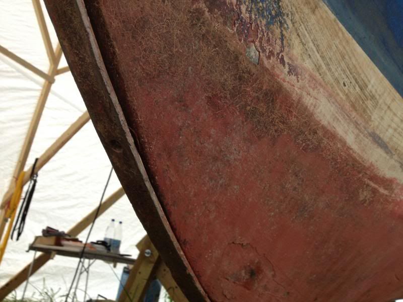

The keelguard is bulging out in a few places. Still unsure what to do with it. It seems like it's just screwed to the hull.
This is where one of the screws has failed, I'll try and remove the old screw and see if I could just replace it with a new one. Or?

Not sure on the keel guard,.....Might be able to get a screw in there,
