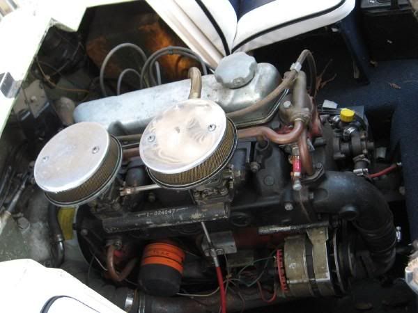

Is it possible for my exhaust manifold to be on wrong? The cooling system in the manual shows my exhaust exiting the rear of the engine, Mine however exits from the front, Out of curiousity I went onto google images to check out other AQ130C engines and came up with one
Its exiting the rear... Mine also has this stupid galvanized elbow someone made to adapt to the exhaust to make it reach to the rear.... Could it be on wrong? Causing blockage?

Some of the early volvo's had the front exit manifolds. Someone may have changed it. Hard to say. Only way to tell if its plugged is to open it up. Have you tried draining the manifold?
