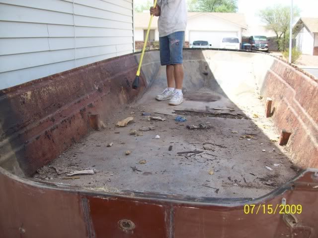

Hi everyone. I just bought this boat($75) and trailer($300) this week for family fun. It is a 16' tri-hull made by VIP. Year unknown but I have HIN and info plate. I am a noob to boating and boat repair, but I am pretty handy with tools. Once I claen her out, I am not sure where or how to start rebuild.Your expertise and info will be greatly appreciated.
It is A 1977 btw

Thanks yt we started tonight and man do we have a job ahead of us. Good thing the family is on board, so to speak. We stripped a lot of the crud tonight. Tomorrow we go even deeper. Deck needs replaced dry rotted badly.Need to pull the cap. The War Department wants Blood Maple on the dash console and side boards. I think it will look good. I am more worried about stringers and such before I get to that.

first thing i would do is check the floor if its soft rip it out then check the stringers if rotted rip those out next check the foam if its waterlogged (dig deep) rip that out next check the transom if rotted...you guessed it rip it out and to do that you will have to seperate the deck from the hull(by removing the bumperstrip frome the boat) it will seperate like a shoe box....im at the point of replacing the transom....when you start putting it back together start with the transom then stringers ,floor,then foam

I expect the time and money part after reading on here. The family bonding on this boat will be a priceless ROI. Planning on lifting the cap today with the help of my kids. Will post pics.

I got tired of the family hiding in the AC so i woke them up early to beat the heat. so here are pics of the cap prepped to be removed, after we removed the cap and the deck stringers and foam that needs remoned and replaced.

man thats ugly....lol....but it looks beter than what mine did ....lookes like you are haven fun anyway..thats what its all about...im having the time of my life workin on mine good luck man and dont give up...its all worth it
meals on reels
by the way did you cut out the slash well...it kinda looks that wat in the first pic
http://forums.iboats.com/showthread.php?t=331731

Your hull will spread without the cap, so either work fast or put some bracing across the top to prevent spread. F-glass dust is nasty in a dry climate, like where you and I live (W. Texas), so wear adequate protection and a respirator when doing the grinding. Search the Boat Restoration forum for Skanky Beast by Jason J...an old thread that shows you the process really well.

getting tyvek suits and repirators this week end. giong to brace hull with masonry board and 2x4. Thanks for all the advice. There are a lot of laughs going around as we work on this good " family bondage" time.
