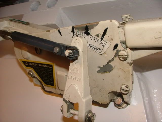

you tension the cables at the top right of the converter box, there are spring loaded pawls that ratchet the cable sheath to acheive proper tension. An OEM manual shows the procedure. As mentioned, you need one of those.
You say you have a full mechanical lower on a 1981 boat-
1981 originally had a hydromechanical lower, was an ESA system added during the swap to a full mech unit?
Boomyal
Aug 16, 2003
12,072
Re: First time in the water with the boat couple of questions
Yep, I think HS may have hit the nail on the head. You can see the slack in the cable in the picture you provided. I had taken the cable tensioner for granted. The manual clearly states that the tensioner can be damaged if it is roughly pulled away from the box. Where the cable enters the converter box, there is molded sleeve on the cable that gets locked into that tensioner. Your cable looks like the spring in the tensioner block, in the snout of the cable entry area is not keeping tension on the cables.

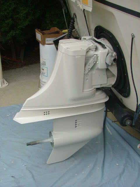

Also, from the picture provided, you cannot tell if it is full mechanical converter or a hydro-mechanical converter. Here is a picture of the hydro-mechanical converter. It does not have all the switches and doo dads on the front of it. If you actually have the full mechanical drive and you have a converter that looks like this, then there is your problem.
Here is a picture of a Hydro-Mechanical drive. This is what your boat should have had. Note that there is no anti corrosion zinc mounted above the lower cavitation plate, above the prop.
Here is a picture of a full mechanical lower unit.

Well I have the same control you have pictured. The drive looks like the full mechanical. It has the anode.

If your shift converter box looks like the picture I posted above, it will never be anything that you can count on. First of all, the full mechanical drive shift converter is strung different than the hydro-mechanical shift converter box. Second, to keep from tearing up your lower unit, a full mechanical drive needs the shift interrupt mechanism (esa) that is included on the full mechanical converter box and must be wired to the ignition accordingly. This is all assuming that your full mechanical lower unit has the proper shift cable. What I do not know is if a hydro-mechanical shift cable assembly will even mate up with a full mechanical drive. They are different.

Yep the converter box is for the hydro-mech drive
