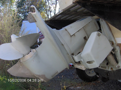

Hello, I have a 88 baretta, 5.7 with a 280VP. I recently replaced the intermediate shaft bearings and bellows.Took her out for a test drive tonight, and everything went fine except little problems. My shift cable is sticking and when put into gear, the gears are slamming. Think that it may be binding somewhere? My 4 barrel carb is popping at about 2,000rpm and seems to be choking out, but runs fine at idle and light acceleration. Also my tilt is not operating all the way up, which I think may be cause it needs fluid and I dont know where to install the fluids and what type of fluid it needs? Can help me get these little problems worked out, or at least point me in the right direction? Trying to make it to saltwater by thankgiving. Thanks

Is there oil on the outdrive, did you check the oil level??
I would think that since the AQ280 has mechanical tilt it would be hard to find somewhere to add fluid, did you use it as a powertrim system??

I did not have this problem before I disconnected the fluid lines.
Can you post a pic of the lines to the pump? We can't figure out if you've got power trim or not. I vote no.

Don't know anything about the fuel tank, but just to clear up a few things, does your outdrive look like the one below, with the "ears" and the cylinders, if so it's the 280PT, and you may need fluid.
If not it's electromechanical and there is no fluid!
I really tried, but I could not find a larger picture !!!
http://lh3.ggpht.com/_6wE8WZAABrI/SycbII07mhI/AAAAAAAABiI/7yDUukJhnaU/IM000497.JPG
