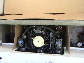

Back to the engine. I'm painting everything like the stock Mercrusier.
I ordered a remote oil drain kit off of ebay. I can drain the oil out of the drain in the transom.:cool:

Well on to the carb. I rebuild the carb and after I took it apart everything looked good inside. I cleaned everything and put in a new kit.
Coming along.:D

I installed a marine grade ele. fuel pump because this was a 1995 Chevy 4.3L block with no place to install a manual fuel pump.
I worked long hours on this engine and it's looking good. I hope it runs:D

While the engine was out I thought I would clean the bilge and come up with a idea of the rear seat and sunpad. The things you can do with large cardboard.
I wanted to design the back seat and cover so I could remove everything but the sunpad to do any large maintance. It will make it easyer to remove/install the spark plugs and work with the manifold if need be.

Well , The engine is in it's place. Time to wire everything up and the hoses. I removed the carb. so the chain wouldn't damage it.:D
I have to take more pics. I will try to download them today.
Good Day everyone. Thanks , Bruce:cool:

Risers installed and getting ready to crank and see if it run:rolleyes: I hope:D
Looking up (oops down ) Everything is coming along.
