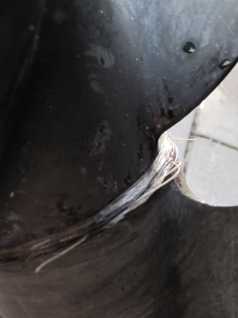

Hi all,
Pulled the boat out this evening to bring home for some routing maintenance/upgrades (putting the bimini on because the sun's back, new stereo components, water sealing, etc). Was only planning to have it out for a couple days.
She's been running great lately, with the only exception being the last few days I've noticed a strange problem. When going from neutral to forward, it's been hanging and not wanting to carry over to first. I had to add more throttle than usual until it grabbed, and then it's fine.
So when I pull the boat, I happened to glance at the prop and, lo and behold...
I couldn't believe it... I never even noticed! If I hadn't randomly pulled the boat, it would have sat there, and I would have run it repeatedly until figuring this out.
So my question is, what damage should I be concerned about? I assume this must be related to my shifting change. Is the line causing excess resistance for the prop, which is why I need more throttle to get it into gear? Could there be any long term damage caused? Seals perhaps? I just redid all the UPPER seals on my drive over the winter, but haven't touched the lower unit.
I'd appreciate if anyone has tips on what I should investigate while she's out. Tomorrow, I intend to pull the prop, remove the line and have a look with a flashlight before doing anything else. Then I'll probably do a quick gear lube change, which I'd typically do anyway just for good measure.

Remove the prop , try to unwind as much as you can verses just cutting it.
If an excess amount is forced under the seals and you find a drip when pressure testing it, then the carrier is removed to replace the 2 seals.

Little update here... Removed the prop, and all the fishing line came off with it. Nothing was stuck in any seals. The only damage I found was that the line had rubbed a good chunk of paint off the prop itself, and possibly on the drive too, but none of it was stuck in any seals or anything. I also changed the drive oil, which was clear green still (yay!) with no apparent debris or milkiness or anything.
Next up, this afternoon, I'm going to run it on the muffs for a few minutes to test the shifting mechanism and see if that's better now that the prop is free. My guess is it will be, but only one way to make sure... One thing for certain, the prop spins a lot more freely without all that line on it!
