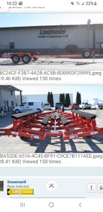

check this pic to see how custom cobalt trailers extend the outer bunks.

Maybe cobalt can tell me what weight the end of the outer bunks carry.
thanks for the help !

Ask Cobalt who makes a Trailer specific for your hull, and contact info
