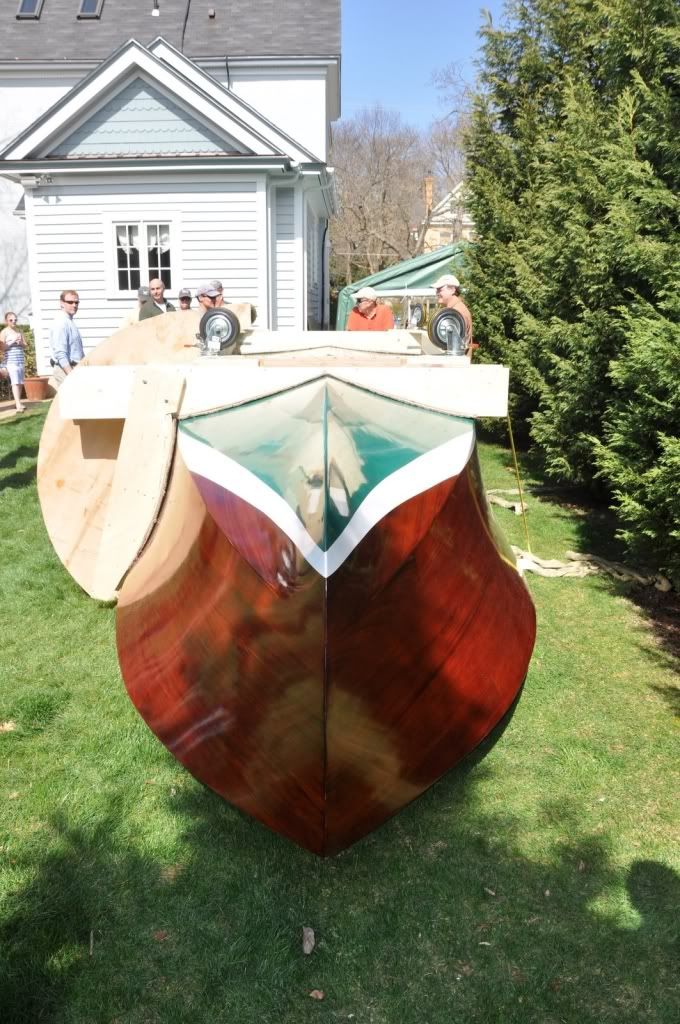

Thanks so much for all the information, it is all going to be so helpful. So I went through all my pictures and couldnt find any of the boat. I did however find 2 on my sisters facebook, I know its not great for now, but it's a start. One is kinda of the inside...you can see it's all open under the bow, the second one is mainly so you can see what the boat looks like.(my grandfather is the one sitting facing backwards). Anyways, I will post some pictures of the damage when I get to the cabin next. I'm just trying to get prepared, so when I go on my holidays I can get to work. I'll keep you all posteed with more pictures.
