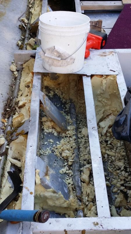

I have a bunch of foam to remove from my boat. Looking for ay tips on this process. So far ive used a square end shovel, wonder bar, hammer and putty knife for tools. Its been a bear of a job. Would appreciate any tips. thanks, mark

This foam removal job is a nightmare! I will never use expanding foam in a boat after this experience. Suprised manuafacturers use it. This foam blocked all channels for drainage. The expansion of it even popped some welds on some sheet aluminum used for seat reinforcement. There is lots of crevices that have foam that i can barely get my hands into let alone tools. Is this a common experience? Hope i dont get burned out on this project before i even get to the fun stuff......
