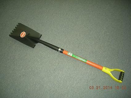

A roofing shovel works nicely for foam removal.
