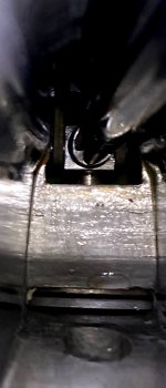

I don't understand why I see tread on the shift shaft?
The rubber seal could be stuck up in there as there with amount of grease showing although I cant really see it in the pic.
When I pulled up on the shift shaft to show the bellows broken, that is the picture you see with shift shaft threads showing.
The shift shaft is loose, like it is not screwed in all the way. I was going to ask about that. If I screw it in, that will change the length of the shaft to where it connects with the connecting pin and cotter pin outside and above the LU.
Yes, I now think the driveshaft rubber seal may be stuck with grease up inside where the driveshaft plugs in. I will check that try to get it out if indeed that is what I see up there.

The rubber seal that should be at the top of the drive shaft is not a big issue.
Just put a light coat of marine grease at the spline and it will be enough.
That rubber seal is for protect the drive shaft spline and crank to rust and get stuck.
Your big issue is the rubber below for the shift shaft.
The below is the seal for the gear lube and it is a N/A part.
I have the same issue with a LU for a 90Hp.
Have talk to Franz Marine and he has a couple of customer in a queue for a redesigned cover with a new style for the seal.
Not cheap at all, try to contact him and check if he still has that solution.
I hesitated because of the cost, had a spare LU which I put on the engine.
BTW: The shift rod looks like it is loose from the shift arm as the threads are seen in the pic.
My thoughts as well.
A treaded section against the shaft seal is going to leak and ruin the seal.
The Force power
Feb 3, 2019
2,359
I would have to check my manual again to see how many turns out from fully seated the correct position is.
The Bigger issue now; you will have to do a tear down to get the shaft screwed into the connector (unless your are the luckiest guy in the world)
Yes, it would change the length of the shaft & the controls/linkages etc. will need to be adjusted accordingly

Notice that the rubber bellow at the shift rod is the seal to the gear lube and it is out of order. First pic.
It will leak a lot and yes the shift rod has to be threaded back into the shift arm.
Maybe you can pull the whole cover and get it back to the shift arm but still the bellow is the biggest issue.
It is a N/A part.

The only problem I see is the broken rubber bellows.
They don't make them anymore and finding one would be a miracle!!
A while back someone posted abut a replacement part, try the search function?
The rubber bellows was only used for a short time in 1989/90 then the end of 90 they realized it was crap and stopped making it.
So that makes the lower unit on your 86 Force a replacement from the stock
unit :(
This part# might be what you need if you can find it?
From the pic of the bellows: anybody guess why it went bad????
The wire tie is the wrong style and was probably put on with too much force.
They need a curved tie(Mercury Part) and very lite pressure.
The tie was probably too tight and made the bellows strech too far and it pulled the top of the bellows off.
Try Franz Marine or be on the lookout for a new lower.
The lowers up to the early 90s including the L drive will swap, at a certain time they started using the same unit on the 90/120/150

1) Shift rod is not removed from the part it screws in to. It was simply unscrewed about 6 turns from being completely screwed in. However, the actual length of the rod when screwed in changed very little (about 1/16" shorter!) So, I imagine the part it screwed in to was just raised up. when I screwed it in. I was initially concerned about the shift rod not protruding up enough to reach the shift rod coupler with the pin up and outside the LU. It looks like it will be fine (I have not tried to shift if yet and see where that is in relation to where it was.
1A), how many turns unscrewed should this rod be if at all?

2) It sounds like I have an 1989 or 1990 LU, identified by the bellows on shift rod.
It also sounds like ALL the 1983-1990+ shift rod seals are NLA? What does everybody do when they need one?

3) Jerry, Yes, boot is wire tied too tightly to shift rod and the pull up probably broke it as the bellows sticks to the shaft now as wire tied.
4), Are you guys saying the bellow IS the seal or is there a seal below the bellows? Nordin says it IS the seal! --- AND NLA!

Radiodan, the bellow is the seal believe me.It is a N/A part.
I have the same issue with one of my spare lower unit.
Check with Franz Marine what he can offer.
I email with he last autumn and the solution was a new typ cover with a regular rubber seal, no bellow.
If do not remembered wrong it was about 200 dollar for it.
The bellow was a bad design and they went for an other design in 1990 I believe.

Well then you would have to be creative and think up a solution.
Depending on how far up the threaded section goes when screwed all the way in and the rod is pulled back, you could have a round alu stock machined to accept a regular chrysler shaft seal at one end, raise it up a bit and weld it to the original plate. Depends on how much room you got inside the leg and a lot of other things.

When Franz sends me the newly machined cover with new seals and replacement shift rod, HOW do I remove the existing shift rod?
The shift rod must be replaced because the one I have with the bellows seal is a TWO-PIECE type that has a larger diameter lower section (as shown in these pics) that would not pass thru the new seal . I don't think it unscrews. I don't want to break anything and I will ask Franz when my cover arrives (probably week of Sept 27, 2021), Anybody know how to remove this shift rod? First 3 pics are looking down the shaft to where it connects.
