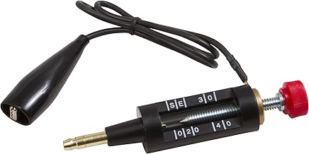

Have a car spark tester that you put on plug and put lead on and see spark can barely see spark but was out in sun so perhaps get inside with less light or is there another type remember I’m uk based when suggesting stuff

Never used one but the ones usually referred to here require a spark to jump 3/8 inch, not just be visible. Up to you change inch to metrics or wentworth or whatever.🤔

Spark check: get a sparkplug with an electrode from
almost any motor, hook it up and hold it against the block
and turn the motor over.
If it makes any spark the system should be good.
Or ask your auto parts stores for a tester like these.

Found tester eBay ordered I can make inch conversion to metric but will have to ask food Fisher for wentworth formula 😂

Hi spark tester arrived to test for spark and strength do I ground the other three plug cable whilst testing worried may do damage cdi thanks all

If checking one at a time then ground the other three to keep the voltage from going high enough to track across the insulation.
