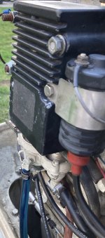

I have swapped the chrysler outboard on to my boat and i wired everything close to the diagram it cranks but im not getting spark... . I believe i have the Motorola cd unit... if the unit is bad is there a "updated" way of getting it to fire
Nordin
Jun 12, 2010
2,748
CDI Electronics has a aftermarket CD box for the Motorola box.
Part# 115-3301, but it is expensive, about 400 dollars.
I suggest you to troubleshoot the ignition system first.
Outboardignitiondotcom has the troubleshoot chart.
The system is quit simple, CD box, distributor with points or a preamp and an ignition coil.
Thats all.
If the distributor has points you can convert the system to regular auto style with points and condenser and remove the CD box.
If you convert to auto style system then you have to change the spark plugs from surface gap style to regular plugs with a bent electrode.
