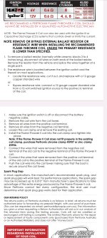

Sorry I'll try again. The wires to my coil positive side are. One to the choke and one to the I terminal off solinoid and the red from distributer. The negative side has the black from distributer and a brown wire that I believe goes into the wiring harness

First your using a Pertonix ignition, so do "NOT" look at the original wiring, you have to look at what "Pertonix" want's for wiring.
Not able to use old and new wiring. Only wire to use with full 12V is white

The white goes to choke..and jumper to coil positive
Correct
The white supplies full 12V when key is ON
White supplies 12V to choke so it heats it up and slowly opens it as motor starts and warms up
It goes to "original" coil to supply full 12V for starting purpose and once started, "using old points" it changes to 6V thru the ballast resistor
You need to focus on just the new dizzy your installing

There is no ballast resistor..never has been. No points either.

Right back to post 5, not relevant
You have a Pet ignition, and it needs to be wired according to Pet, not the original wiring

I understand that...post 7 is what I have found..from pertronix
