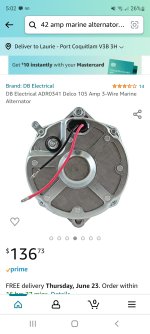

Like this
52,511
It shows 105 amp
You have to rewire your boat to use anything over a 42 amp alternator.
It can be done, however you need to replace wiring from the alternator to the battery and the helm. You have to bypass the ammeter.
