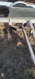

  • One of the steps was broken from the welds in the past, and wasn't welded in the correct location:
    • Might be fixable by grinding the bad weld and re-welding it in the correct location. Or I leave it the heck alone?

That said, I found out what likely happened to the re-welded step. The angle roller bracket on that side was bent and I wasn't able to hammer it straight (at least with a 4lb drilling hammer, I didn't try the 4lb mini sledge). Likely, something terrible happened (trailering crash?) that bent the roller bracket and slammed the step down (hence why the weld was busted inwards). They then bent the step upwards enough to move the bent roller bracket back into rough alignment and welded it there. Not a pretty repair, but I may let it go since it may be a mess fixing it. Or not... I'm sure it can be straightened with the right application of leverage/force.
I've completed the first bit of planned demolition work... getting the angle rollers removed. This was fun due to the rollers using push nuts on the bottom... inaccessible. I ended having to destroy the upper end rollers to allow the shaft to drop low enough so I could pry the push nuts off the shaft.
