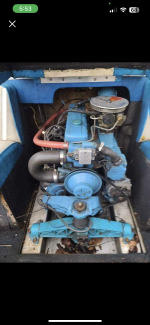

Hey!! Long story short, back in 2009 our 1976 Starcraft with a OMC 2.5 was stolen, and finally this year in 2022 we found it sitting in the bush!! It’s a darn disaster but its so fantastic to finally see it again after having forgotten about it!
Whoever stole it, messed everything up. I got the boat to turn over (by jumping solenoid, key on the “start” position still gives power, but doesn’t open the solenoid to start) but theirs no spark.
Went through the typical list , points & condenser, looked fantastic still cleaned the contact, put new plugs (since I had some laying around) the coil have power to both positive and negative side, I unplugged the low oil safety light (incase it mattered) unplugged the grey wire from coil that does the Shift Interrupt Switch, still no spark.
Obviously, probably a wiring issue, or something else is dead.
Is there a way to actually “hot wire” the motor to confirm its a wiring issue or a parts issue? I remember the old Ford 3.0L you used to jump a positive cable directly from battery to coil and that would bypass the key.
Yes, I do have the key, it’s a spare from all those years ago.
Any input on which way to start would be awesome, thank you!!!
