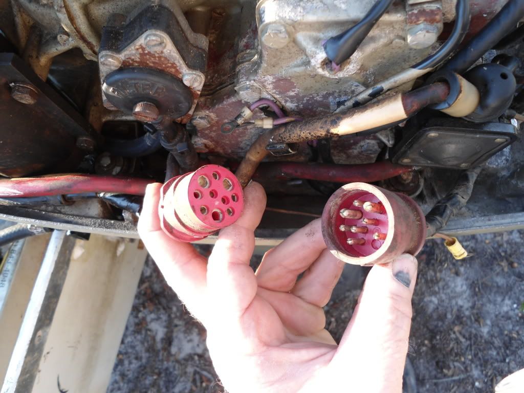

Hey everyone , I need help on this 74 evinrude. I know as much about outboards as my future son in law.Basically nothing!
The problem is this fuse in the pic keeps blowing . It will last for a while then blow when starting. I would greatly appreciate any help with this!
Thanks S.P.

That indicates you have a short somewhere. Check all your wiring and look for a stripped/damaged cable. It looks like sometimes it hits the ground shortening and blow fuse. Have a good look where cables are near or passes thru metal. Also check for the amps in the fuse...How many amps is it?
daselbee
Jan 20, 2009
2,765
Re: Future son in laws rude
The short that mekkamaz refers to is probably not at the engine, but up in the boat. quite possibly the key switch itself. Rig a 12v light across the two fuse terminals. Move/play with wires all thru the harness and remote and key switch...when light shines bright, you have located the short. Pay special attention to the red wire up at the key switch, the purple wire (goes hot when key is on), and the yellow/red wire.....goes hot when key is turned to start. If any of those wires has an intermittent short to ground, the fuse will blow.
Also, pull big red plug apart at engine, and check for corrosion.

Thanks guys, model# 50473m
ser# E0002945
20 AMP 32 V fuse.

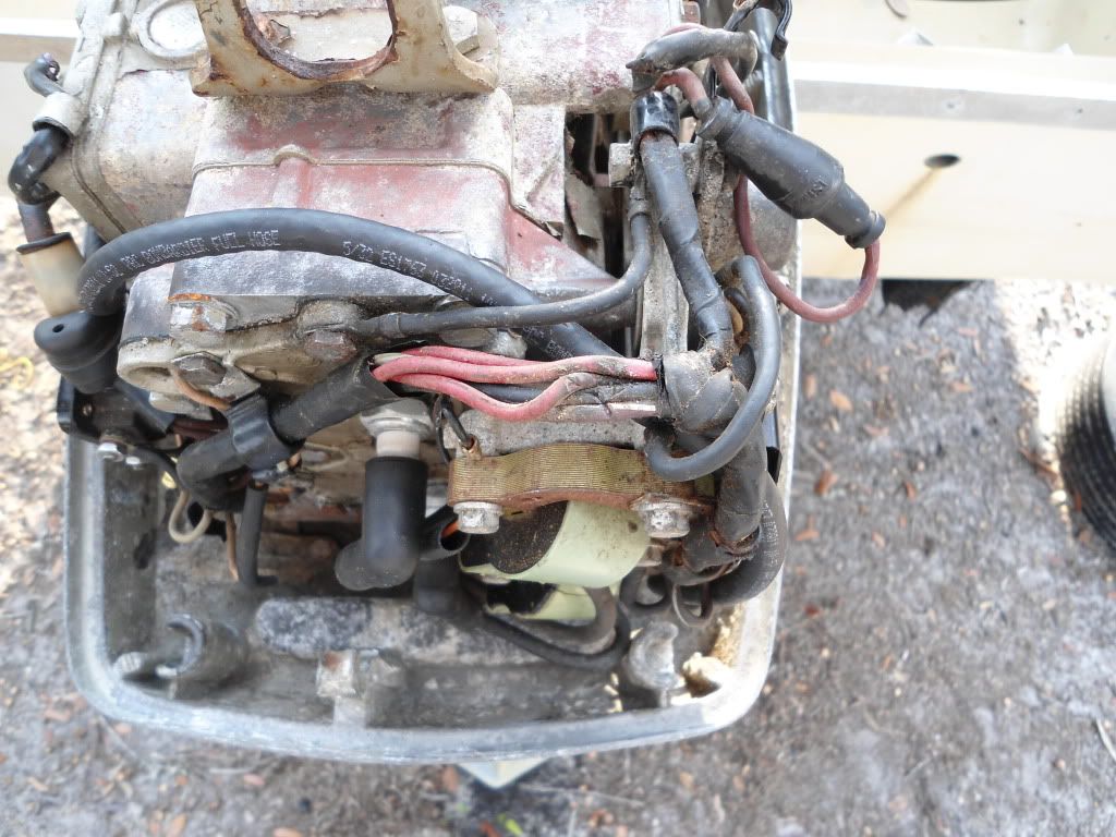

do you think this might be the culprit...
maybe moisture made it ground out? harness looks ok I think.
I,m gunna pick up some more fuses tomorrow and see If get it to blow .
We taped the skint up wires individually .
Thanks again S.P.

I'd seriously consider replacing those wires rather than the tape job. Looks a little suspicious...like someone cut all three...or a sharp bracket edge took out all 3...look how they line up in the pic you posted. That engine's definitely been run in the salt a few times.

Thanks LongLine I pulled the insulation back on the wires there may have been broken strand or to but not cut thru. Can I splice the wires with crimps and then shrinkwrap? I hope that by isolating the wires I can tell if that was the problem. And yes salt water is the only thing we run in..

THose wires are corroding from the inside out. Taping/shrink wrapping them is not going to help, if it does only temporarily.
Do a voltage drop test and see what kind of resisitance you are getting through them.

if you choose to splice , rather than replace, avoid the crimps, solder and heat shrink. ( use a solvent to remove any excess solder paste before the heat shrink, and jmo, but i like to use a bit of silicone on the joint before i put the heat shrink over it)

I put new fuse in today and started motor about 15 times . It never blew so maybe that was the problem. Picked up a soldering gun from H/F and will solder then shrink wrap the bad wires. Going to start it over and over and see what happens.

Just a tid bit. When ever you solder a wire it makes it brittle and it can break easier from vibration. Best to use heat shrink terminals on both the mtr and in the boat wiring.

with all do respect....i have never seen a wire break due to vibration at a solder joint, but i could see it happening if a butane/propane torch was used, and the joint was severely overheated before the solder hit it. but unsoldered joints, especially in a salt water used motor, will turn green and fail even with heat shrink .....in a short amount of time.

I think you'll be okay for a while if you use an iron for the solder job. But keep your eye on it. I'd also check a few other wires on that engine. i.e. other tape coming loose, rub spots, etc. Make sure you have all wire positioned correctly & your cover doesn't hit anything when put back on.

Got the wires fixed thanks for the help . Has not blown a fuse since!
