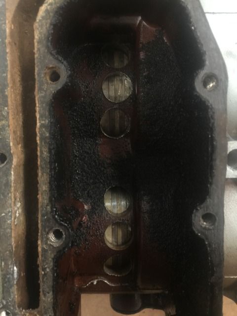

I've got it tore apart, and have the rear clamshell cover off, but have a question.
Want to take the pistons out and put the whole case in the parts washer and clean it up.
Do I just pull pistons and crank out of the bore? It looks like it will come out easily enough, but the bore doesn't have the beveled edges like I see on other two strokes like chainsaws.
How do I get the rings to slide back into the cylinder?
Will I need a special ring compressor?

Are you sure the bores aren't tapered? I'm thinking they are. I do know that the older Gale 5's needed ring compessors, but I don't think this one does.

Well, was looking through my pictures, and appears that maybe they are?
I see a slight taper, which may be enough to get them to go. I actually hadn't saw that till I looked at the picture, was envisioning a larger taper I suppose. Does look like there are larger ones spaced out, guessing that is enough to squeeze the rings and set them into the smaller taper?
Will try it this weekend, was just concerned with catching a ring and breaking it trying to get it in there.
