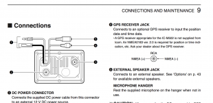

First off hello! I'm normally over in the Volvo Penta I/O forum. I have a 25 foot Parker pilot house and I'm trying to make sure all my safety equipment is in order since my kids will be on board.
First , I have very little understanding of electronics but can quickly understand concepts and clear instructions.
Here is what I have and what I'm trying to accomplish. I have a ICOM M502 VHF and it has a DSC button and the ability to have a GPS connected in the back. See image from manual. I also have a GPS on the roof of the pilot house and the cable comes down thru to a chart plotter.
I started by calling ICOM and they were awesome but the things they were telling me were a bit over my head. He said to get a red RCA connector and to solder some wires from the GPS unit and connect to the negative bus or something. I tried to follow but got lost and I dont even know what to order yet.
I did find this article with my exact radio and they do show parts but I dont know every where to buy the "interface box." Another pic attached from the linked article.
I'm wanting to know if the GPS cable I have can be "split" and connected to the back of the VHF. If not, can anyone direct me to a site where I can buy the components to make this work? The puck shown is easy but I don't know what these other two parts are or how to connect them all. I did find the12v-5v converter here.

What GPS do you have?
Scratching my head about the interface box. I see no reason for it. All your doing is adding a RCA connector to the TX and RX connections (bare wire) on the chart plotter.
The wire(s) from the gps antenna go directly to the plotter as well.

Don’t understand the need for a 12 to 5v adapter. Position is coming in from the plotter via the RCA connection

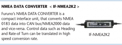

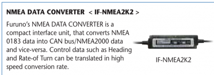

I found this today. My Furuno 1870 seems to have the ability to connect to a VHF but the ik-nmea2k2 cable they reference is almost $160!.

It sounds like that you'd need that converter if one component uses NMEA2000 and one uses NMEA183 which is the older system. What do the GPS and your radio use? The radio I bought this summer uses NMEA183 just like my GPS so it was an easy connection.
It appears that these can be connected just by using the RCA cable, is that not so?
I can't see why you'd need a NMEA2000 cable for this.

Both are older, discontinued units. Neither unit is NMEA 2000 compliant.
No short cuts here. Need to use NMEA 0183 connections. Solder RCA connector to Tx and Rx (NMEA 0183) connections on plotter
Don’t remember if you need a male or female RCA but this is what you need
