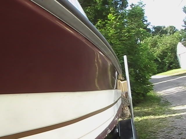

Re: Gel coat cleaning???
I just got all of that black stuff off of my boat. I used green works multi purpose cleaner. It is like windex. Then I used turtle wax rubbing compound to buff out the oxidation. It worked great even without an electric buffer. here is a pic.
