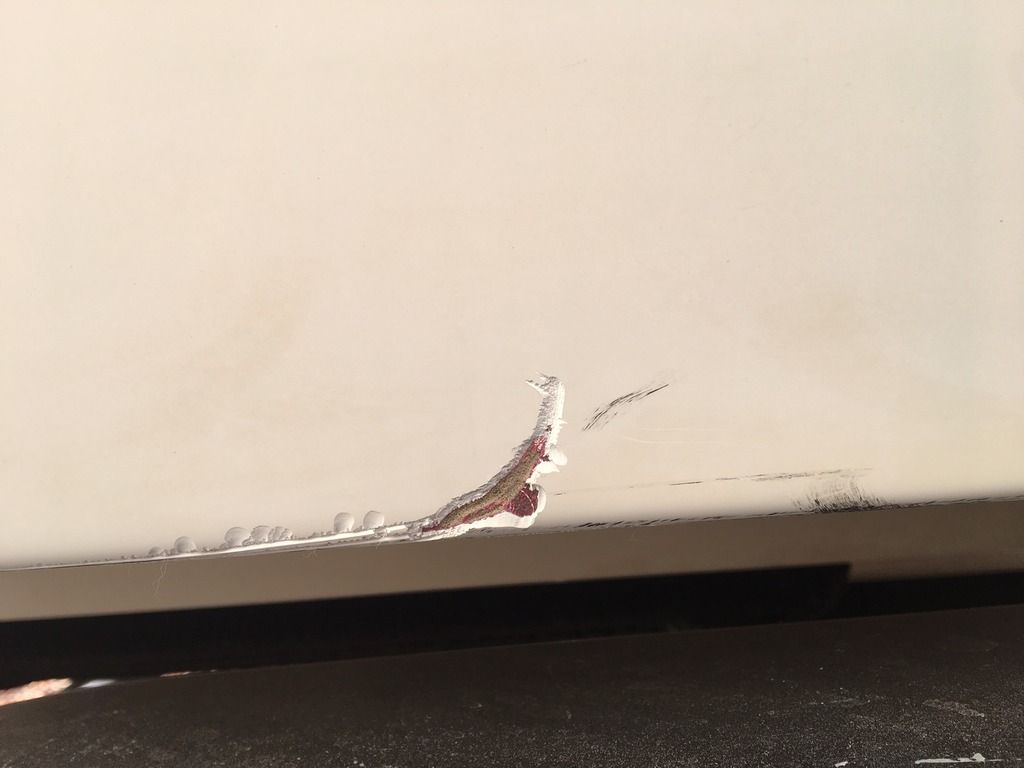

I have a nick in my gel coat from last season that I need to repair.
My plan is to lightly sand the whole area and gouge, clean with acetone and apply the Spectrum Gel Coat Repair with a squeegie. Once dried, sand, polish and wax? Should I do it stages or one coat?
HERE'S THE NICK:

You will end up doing it in at least two stages. I did a 2' x 2' section of dock rash in a similar fashion with spectrum on the searay
Woodonglass
Dec 29, 2009
25,932
I agree ^^^ first application will fill it. Sanding will remove more than you want probably and then the second application will do the final fairing and blending.
tpenfield
Jul 18, 2011
19,373
Usually, you stick a small piece of clear rigid plastic (report covers work fine, or salvage something out of the recycle bin) over the gelcoat once you apply it so that it forms a smooth surface with the surrounding area. You can also bend/shape the plastic overlay to contour to curves areas. Sanding is then a bit easier with this approach.

I use wax paper after I apply the gel-coat. I use a thin bondo type spreader on top of the wax paper to smooth things out. I pull off the wax paper a couple hours later, and like Tpenfield say's you get a real nice shiny surface to work with. This method seems to need less sanding for me. Dave-R

After 1st coat. Weather was not conducive to a second coat...next week.
I let dry overnight. Then sanded with 150...200...400...600...1500...polishing compound (with buffer) and finally waxed. I'll get more pics this weekend. And with any luck finish it off, weather permitting?
