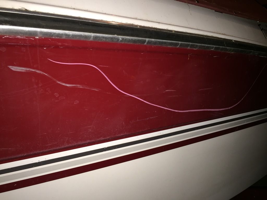

I have a gouge in my red gel coat inflicted by a dock corner from my slip. I've been watching many U tube videos and there appears to be a multitude of approaches to fix this. Im not sure if I need to fill the gouge as it doesn't appear that deep and Id like to avoid having to dremel it if i can. Im just wondering if after prep, whether surface application of gel coat with a buffer will be sufficient to fill the gouge. I guess what Im asking is this...... how deep does a gouge need to be to require prep gouging before gel coat application. Probably a situation dependent question but any words of wisdom would be appreciated, don't want to get in any deeper than I have to ( no pun intended) Thanks for any help

Hopefully these photobucket links work, first time Ive used the site. Scratches are more superficial than I remember from last season. When i drag my thumbnail across it it does drop down into it but very slightly. Not sure if that helps but again any help or suggestions would be appreciated

Unfortunately Red Gelcoat IS the hardest color of them all to try and color match. 21 years of sunlight has not been kind to it and trying to match the color will be almost impossible and then even if you do, in a very short time it won't match cuz the New gelcot will not fade at the same rate as the old will. First thing to do is wash it really well with Tri Sodium Phosphateto remove all contaminates and then do some light wet sanding with 600 grit paper. Dry it off and see how it looks. You might be surprised. Report back with more pics and if you want to go further we can/will give you more guidance. That's this Old Dumb Okies advice.

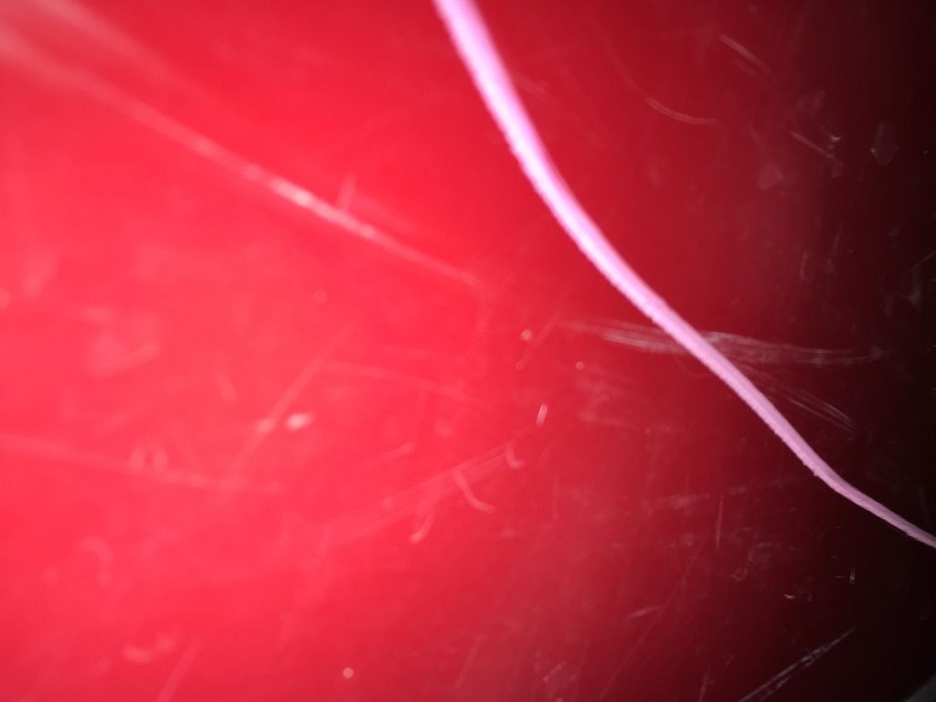

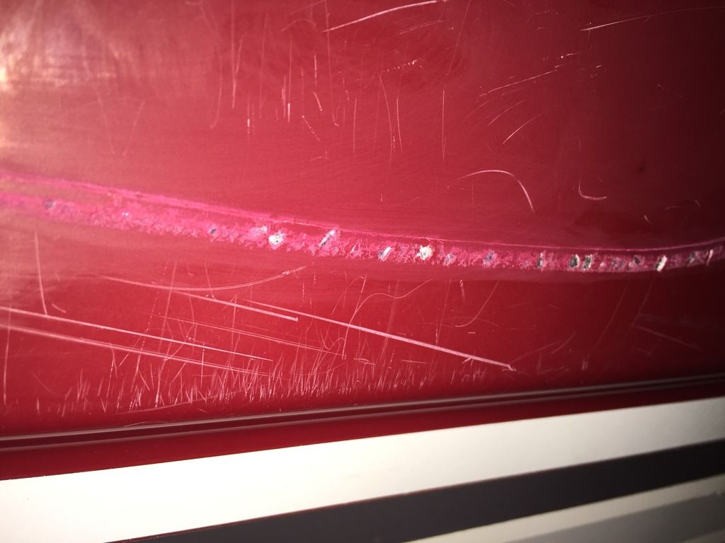

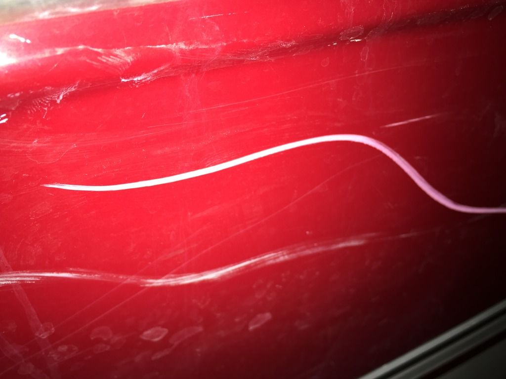

the following several posts show where I am at as I've wet sanded with 2000 grit sandpaper and managed to get the majority of the gouge flush with the surrounding areas. there are close ups of the area that went a little deeper and appears to need to be filled. The question is filled with what? Ive looked at several products including Magic Ezy and spectrum gel coat patch paste repair, the latter of which is not available in the color for a 1995 model boat. Obviously I need to properly fill these areas first and then address restoring the areas adjacent to the gouge. I guess I need suggestions on how to proceed next. Again, any and all help is greatly appreciated

Again, trying to match the color will be your biggest challenge. I still recommend gelcoat paste to fill the chip out areas after you've cleaned well with acetone.. Overfill and then sand smooth. Scracthes can be filled with a bondo spreader forcing the gelcoat into the crevices. Then it's a matter of using a Power Polisher and various compounds to bring back the shine.

I'd use a Gelcoat repair kit sold right here on iBoats. It's your best chance of getting a color match. It will take patience and time but...it's possible. You'll also need some cabosil to thicken the gel into a paste
