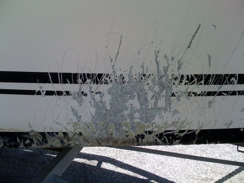

Do you suppose this could be fixed with gelcoat?

yeh that has to be fixed because the gelcoat is gone so it needs new gelcoat to seal it up, mat is porous as a sponge.
Powersand it and feather the edges out, if its deep into the mat start with mat and resin, then thicken gelcoat with cabosil and chopped fiber to a paste and apply it, sand it and apply gelcoat and finish sand.
