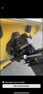

Pickup a 1998 baja sidewinder 320 hrs . Left in water during part of summers under cover slip so it does has a few areas of small bb blisters on bottom of hull, not many . Need some thoughts on what to do to gel coat cracks around outdrive plate No leaks so far but want to prevent transom rot . Transom and stringers , limber holes and upper deck very solid . I want to pull the motor and transom plate to repair cracks. The black caulk is not normal I am sure of that unless it was something that Baja did on that model or was done later if transom seal was replace . Any thoughts or I am worrying too much ?

normally when somebody runs a bead of sealant around the transom housing it is leaking either from a drive impact or rotten transom. Did you drill into the wood of the transom to verify they are sound? Are u sure that is gel coat and not a repaint of the boat? If the transom is indeed sound leave it alone IMHO. I suspect the boat was painted and u see some peel back around where it was taped off and hard to prep for good paint bite.
big issue i see is why did some one seal that area. I would be worried about loose transom plate nuts and rot. If thats not there look ate the bow and enjoy it

No core samples … but I did use a moisture meter had no significant readings inside or out . Tap with mallet. Transom hardware seems tight. Hopefully transom ok .

Ive never had to deal with transom rot but general consensus is you can only really tell by drilling , if wood shavings come out dry just seal with 5200.
transom hardware being tight is a good sign.
