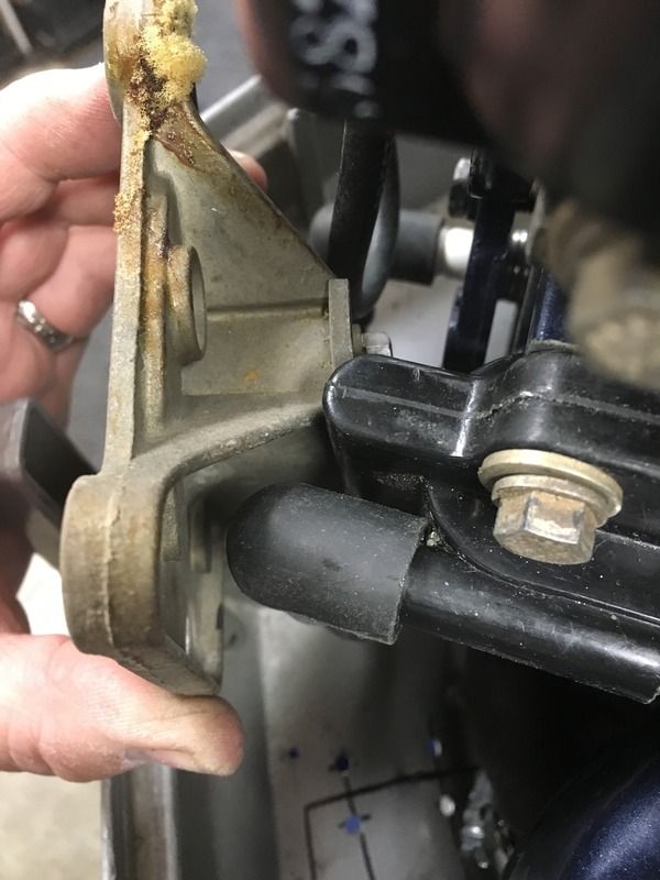

Dressing the engine. Today it's ignition bits. But the coil for #4 is fighting me. Original orientation on the 90 was with the plug wire pointing forward and next to the exhaust housing, but that interferes with the bubble butt on the new motor. I scavenged the bracket off the scrap cowl to make some tests (he he he).
There are only two ways it'll mount and not interfere with the cowl latch bracket - which is better?
a) Plug wire points rearward and sits next to the latch. The latch body looks like it'll be pressing on the coil housing if I go this way.
b) Plug wire points forward and exits near the head.
Open to suggestions.
