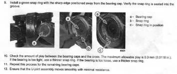

1. Pressed one cup slightly deeper to have space for the groove, put the clip into the groove nicely.
2. rotated the yoke 180*
3. then pressing another cup and tryin to fit the clip - No luck... its almost there, missing maybe 0.01mm or something
I was wondering about sanding the Clip a little
now its 1.50mm tickness same as the old one so no idea why its not fitting
I have found also instruction sheet from OEM Mercs and Ive followed almost the same steps.
