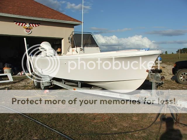

UPDATE!
I started spaying today. I had some orange peel but I added more acetone and that helped out. This is the first coat. It is not perfect but I'm overall happy with the results so far.
I thought it would be alot more glossy however it is not and thats the way I wanted it to be.
Am I able to wet sand this paint?
Here are a few pics before and after.

Re: Going to try Rustoleum to paint entire Boat
you may want to research rustoleums website and see what they recommend for air pressures and tip size on your gun.
Yes you can wetsand rustoleum enamal. I'd personally wait double the time it says on the can. Then 4-600 wet oughta do ya. After that, follow up with a coat or 2 of clear coat. Then your favorite wax.
trayscool
Mar 31, 2008
46
that looks really good in the pictures. remember that no paint job is going to look as fresh as factory gel coat
tashasdaddy
Nov 11, 2005
51,019
the clear is what really puts the shine on it.
I got a total of 3 coats on her now and she is really looking awesome. Still a lil bit of orange peel but really not a big deal. Getting the air pressure set correctly and the amount of thinner was the key to a good spray.
I'm now at the point, trying to decide if I should wet sand it down and then clear coat it, or just leave her as is.
Any input? I will be posting some more pics in a little while.....:)
