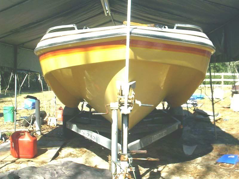

i think we need pics......you might have to rip out the keel gaurd.
but.....when posting pics.....after you up load to photo bucket....resize to 640 x 480 then copy the img tag..........and just past it in your responce.......other ways you get those thumbnails and they arent really big enough to see areas we need to see
x
i op'd out on the keel guard as they all say it can't be use'd on a roller set up , besides there was no use installing one untill i had this leak thing fix'd ,
i'l keep trying on the photo bucket thing , never had any problem linking pics befor but normaly i use one of my own photo gallerys one i use for my car site Starquest I-x net and the other for the other car sites i'm on, both are unlimit'd in size and always there :)
clicking on the thumb nails gives you a full size'd pic , but i'l take some more pics as soon as it stops raining

ok i'l try to upload a couple pics from photo bucket

the dirty dark spots is oil stains from the water we were in , last week we fish'd was the florida power plant discharge out let and they were dumping some clean out that had an oil flim to it
i did notice some black rub marks from what apears to be a roller that is not spining , but slideing,, thats strange as all rollers spin very easily by hand with boat off trailer
now back to the repair area on the keel he said he'd come back to finesh it out with color in the cell coat,,but i haven't heard from him nor does he answer phn calls ??

shelby....love the photobucket pics.....but can you get us a close up shot of the area where you suspect the leak is? including movung the boat back....so the roller is out of the way before the gell coat goes on........it isnt fixed if there is still water comin in.....so there is no use him putting the gellcoat back on
