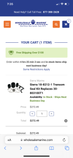

off topic question, is this a good quality transom kit for the bravo 3 out drive?
alldodge
Mar 8, 2009
43,740
8M0095485​
This is the full kit which includes the exhaust bellows. May want a exhaust tube 78458A1 with the B3. Or can pic a choose parts as Scott mentioned

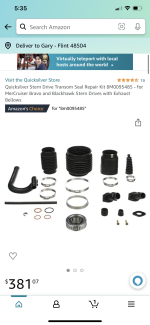

ericcarr
Jul 27, 2009
293
I got this when I punch it into Amazon, is this oem?
