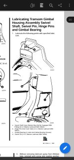

We're talking about the swivel pins presumably? I think of the hinge pins as up/down movement. No zerks on yours? Screenshot_20220409-092310.jpg

Whoops, that page is from a gen 1. Actually can't r remember if my '86 has them or not. Could probably drill and install a zerk on the Gen 1, since it originally came with one, not sure if that would be possible on a Gen 2?
