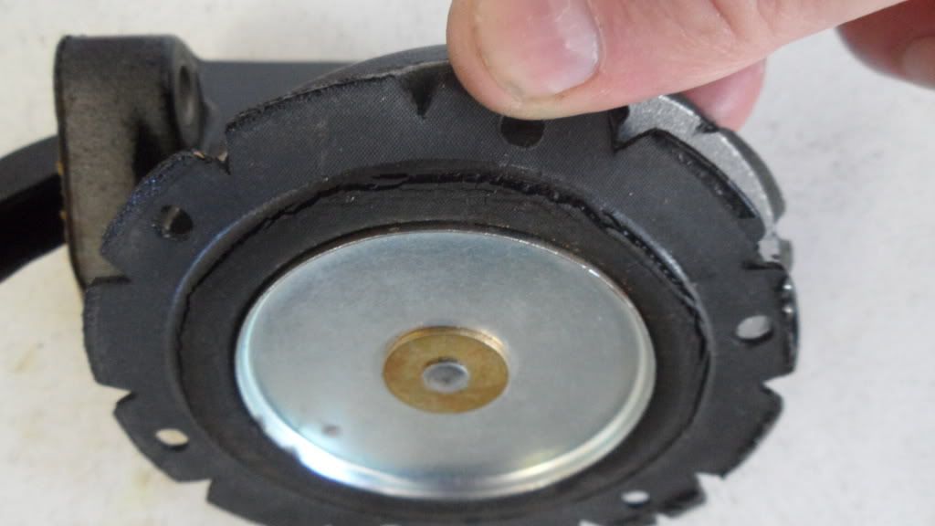

I had similar issues when I bought a '90 5.0L. My issue ended up being a bad fuel pump diaphram that allowed excess fuel into the carb airhorn via the sight flow tube, causing a flooded condition between starts. A new fuel pump solved that problem (a boat 20+ years old...Ethanol fuel is not good on the rubber diaphram). Its something easy to check while the engine is running.

ktbarrentine, can you elaborate on what you saw that caused you to know the fuel pump diaphragm was shot? I have the same issue where my 4.3L on a '90 sea ray starts and runs great, but takes some cranking to start after it is up to temp. I want to check this fuel hose you mentioned but would appreciate some specifics. thanks!
The sight-flow tube is a clear tube that runs from the fuel pump (above the diaphram) to the air horn of the carbeurator (mine comes in at the aft side of the airhorn). When the engine is running, you can either look at the airhorn with the flame arrestor off, or look at the sight-flow tube that runs along the intake manifold to the airhorn (my SF tube was actually very discolored/yellowed by 20+ years of age, so couldnt see much through it, but did see the gas coming from the SF tube port into the airhorn... After I replaced the fuel pump, I also replaced this SF tube. A bit pricey, but it is a "special" material... Do not use tygon or vinyl tube!!!). I did a post mortem on my old fuel pump and found that the diaphram was shot! I have been told this is due to leaving the boat in storage with ethanol fuel in the pump.

Thanks for the further info on the fuel pump and clear hose. I'll look into mine. I appreciate the info and photo.
