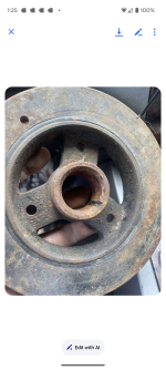

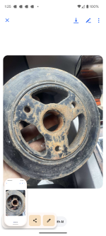

Is this harmonic balanced pulley great OT not?

Alumarine
Feb 22, 2005
3,762
How can I push the harmonic balance in? Rubber hammer or special tools?
Heat it up in an oven and tap it on.
Make sure you don't melt the rubber.
Google "heat harmonic balancer in oven" for some ideas.
