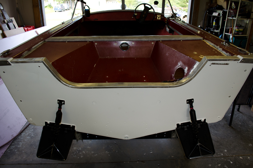

I work in sheet metal and have worked on my SS and believe if I were going to attempt to shorten it I would consider moving the transom forward.
Remove the splashwell. Then the complete transom skin as a whole. Cut the hull where I want the new transom location to be trying to maintain the original transom angle. Trim the back stringers to mimick the distance from the old transom skin. Reinstall the transom skin, kneebrace, transom, and splashwell. Hope my math and geometry are correct. Reinstall the motor and take her for a ride.
Lots of work and math, but I believe it could be done.
Ofcourse I've only done minimal work ( Replaced the transom, and repaired a few rivets) to my Starcraft so I would divert to Wateemann, dozerII, Budski, jbcurt00, or some of the other more knowledgeable members who have actually torn down a tin boat and rebuilt them for a true opinion of whether shortening a Starcraft is wise or even doable.

Starcraft hulls have a taper, usually the transom is narrower than the beam. That makes moving the transom closer to the center messy. And of course makes cutting the middle and overlapping the hull another bad idea.

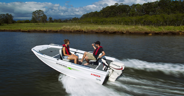

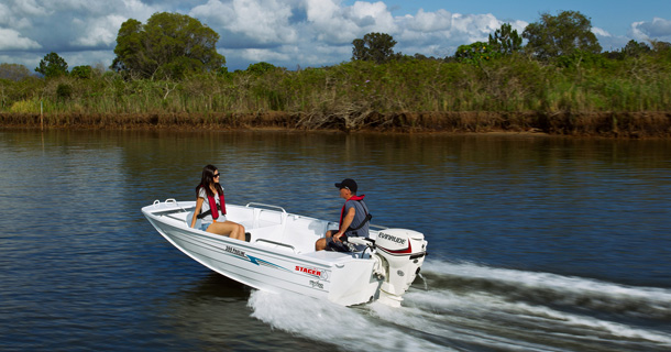

GA_Boater suggests what I'm trying to do would end up a tub and handle like one. I'm fine with that. I would like to end up with something similar in dimensions to this Stacer from AU above.
Hull length: 4.10m
Beam: 1.87m
Depth: 0.88m
Weight:255kg
Now if I could get a 16' squeezed dow to 13' -14'.:D

Beyond being a boat, an SC has very little in common w the shape of that Stacker

You are looking for a deep and wide jon boat in the USA.

I don't know where anyone can get the idea I'm looking for another jon boat by looking at the Stacer.
I like it's dimensions but not it's interior layout.
