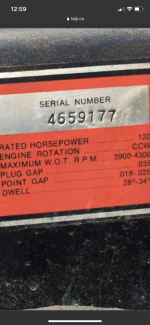

I have 2.5L 120 s/n 0C661190 with a cracked head, I found someone selling a good head of a 120 s/n 4659177 are these heads interchangeable. I could not find a look up that would accept the 4659177 serial number for me to reference.

This listing shows one head for the 120 from ‘63-’89 so i suspect only one head was used the entire run of the 120
i think the early serial numbers like you are looking for are pre 1982 and most places dont have listings fir parts

Thanks so much again Scott! And also the S/N explanation makes much sense.

there is one source that has the serial numbers for both the engines listed. the head in both cases is P/N 936-5319, so you should be good to go.
