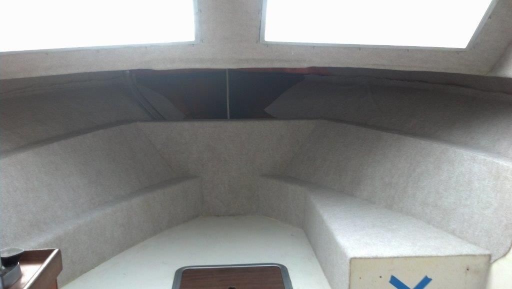

I have attached a pic. Having a hard time figuring out what to line the ceiling of this vberth with. The blanket headliners seem too thin and would require a lot of cuts and seams. Is there a better way...panels maybe? Not sure how to handle the corners. Totally lost here!

Heres your pic, with some scribbles on it :laugh: If i were doing it, I'd start with the area in yellow, the 'hump' around the hatch, glue/wrap the carpet around it and trim it off flush to the top/roof of the cabin. Then rough cut and fit the green or blue sections next, as separate pieces.. in the end as long as you leave a bit for overlap, and final trim nicely at the edges, it will look seamless.
OR, you could do the green part second, and leave an 'even' amount of overhang into the blue area, (say 1/2 to 1") and in the end the blue area's carpet would overlap it.. could easily be trimmed and glued nicely, and I think it would be almost unnoticeable. One thought further there, if it is noticeable, you could run a thin teak/other wood trim right over it, all the way along that edge to 'hide' it :lol: and it wouldn't look out of place in that cabin..
I guess it depends on the thickness (pile?) of carpet you use, and the color as well..

That's looks like an awesome idea, I think I will give it a shot over the long weekend... thanks!
