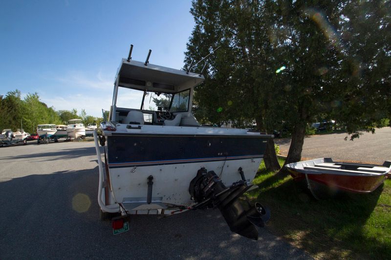

flyingcow
May 7, 2015
36
So I took delivery of the boat today. It's at a local shop to do the bellows and trailer work. I want to dive in to the outdrive, but I want to get a little more time learning the boat before I start disassembling. I noticed some things that might explain why it was running so slow. The outdrive is the 1.81 from the original 4.3. So the motor is spinning a bit faster than it needs to be. Once I get the boat back and in the water, I'll take a look at the throttle linkage to make sure I can get to WOT. I should have been on the high side of RPM's if the gearing was the only thing going on. Once I get this part figured out, I'll look deeper into the prop itself.
