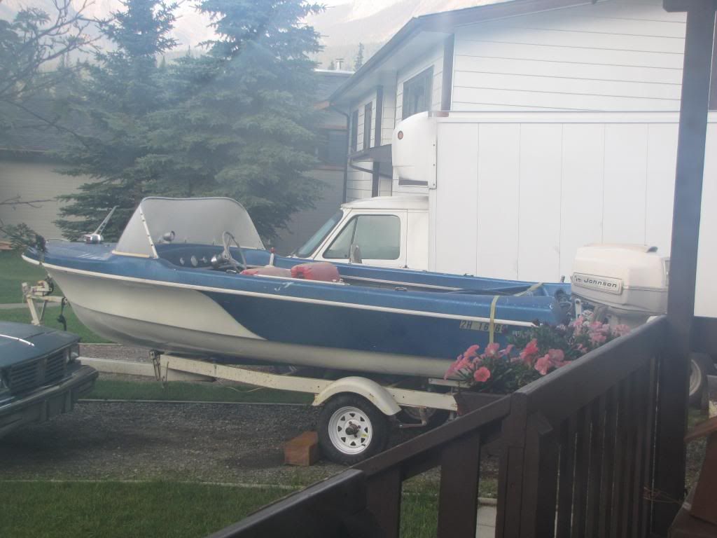

Jim, parts are expensive enough. special tools are not my favourite thank for the heads up. Funny you should mention old OMC's
1967 100hp bought boat motor and trailer for $300 and ran it for many years never let me down but hull got too soft sold it for $600 this spring.
