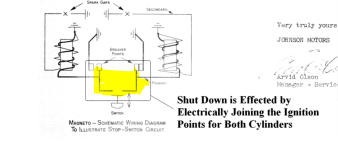

killing the motor involves shorting the 2 M wires if the switch is a problem you can rig up any normally open push switch and kill the engine by pushing it

the vacum switch kills one coil as per description(high rpms) . on some motors the anti-start neutral control device can be mechanical or a simple mercury blob in a tube that shorts to ground only when attempts are made to start the engine in neutral. Out of neutral, the tube tilts and opens the needed ground path.... preventing the solenoid to be energized from the start key START B+.
if you remove the FW you will find a set of wires added on the condenser - coil connections on the points. those are the ignition kill wires routed under the mag plate to safety devices or wires.
