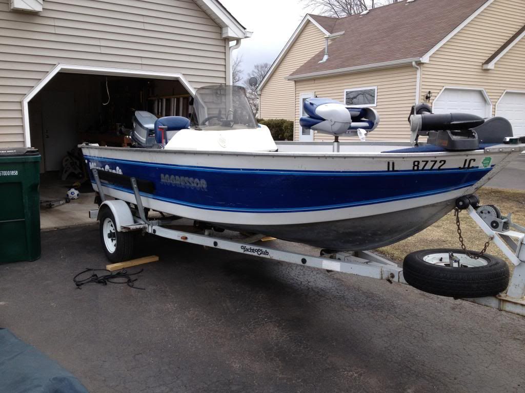

What aluminum boat?
I know pix are challenging to post lately, but using photobucket, I've not had any trouble.

Heres a pic. Bought the boat a few months ago, took it out a few times. Learned livewell had a leak. One thing led to another, seems transom is rotten on that same side so in turn doing a transom replace and probably a floor replacement. I may just do the transom now and fish it the remainder of the season and take on the floor come winter. Seems like double work but I want to get back out on the water.Going to see how smooth the transom goes first.

I like the boat! Mirrocraft looks like they are trying to make a big comeback recently. Post updates and I'll follow.
